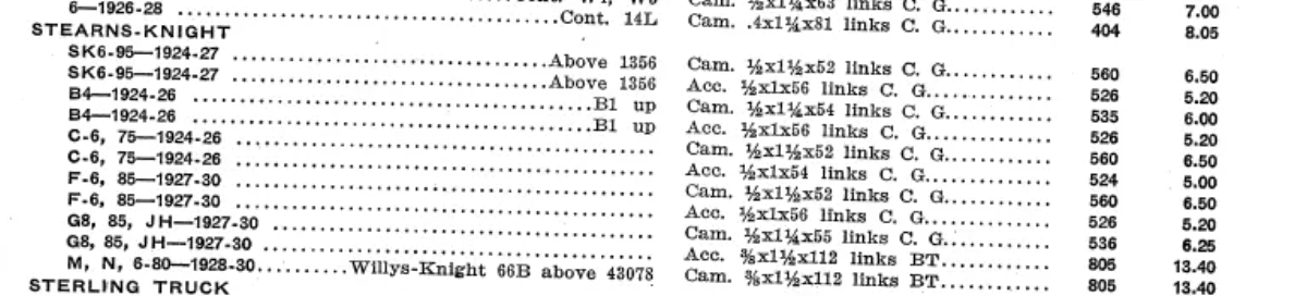

Per Jeff Darnell this is the timing chain replacement for the 8 Cylinder Stearns. Available through Ramsey .
