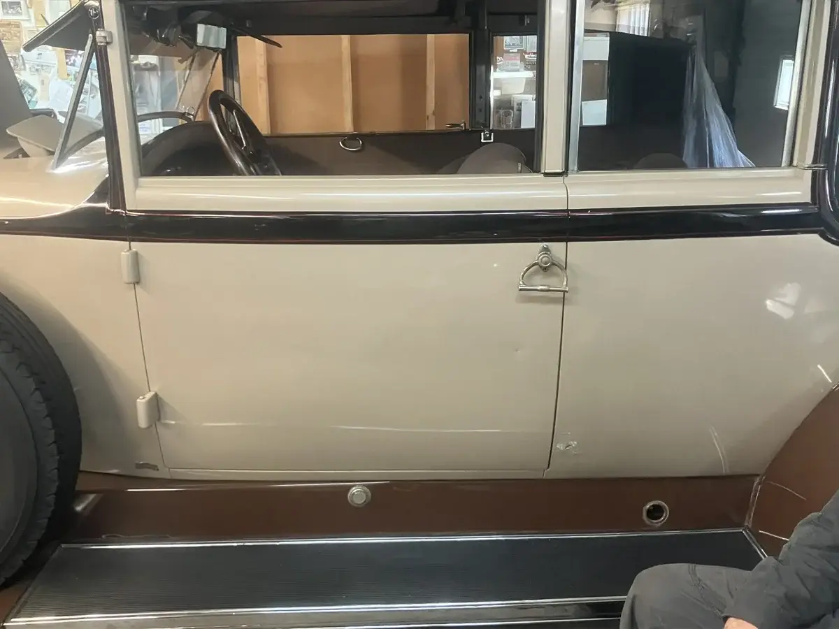

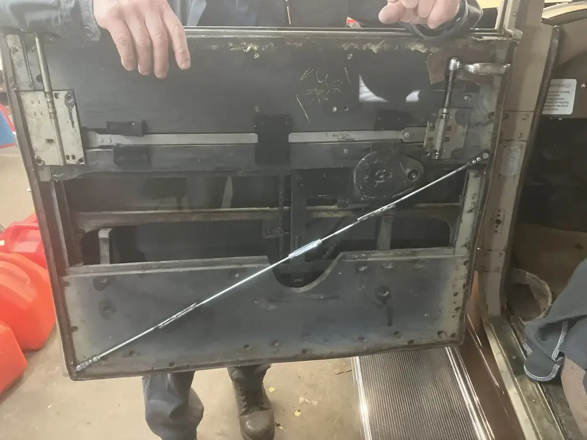

Both doors on my Stearns kicked out on the bottom corners significantly. I had to find a before picture because like a dope I didn't take one. This is the 4th car I've owned that we have had to add turnbuckles to. This one was a little trickier because of the window mechanism. Many times you can go corner to corner. It still has to be recessed so the door panel can go back on.
