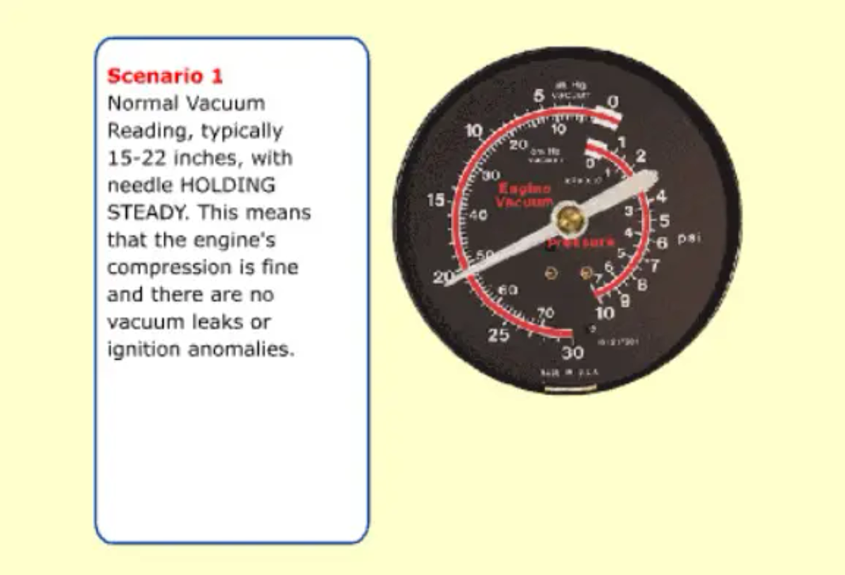

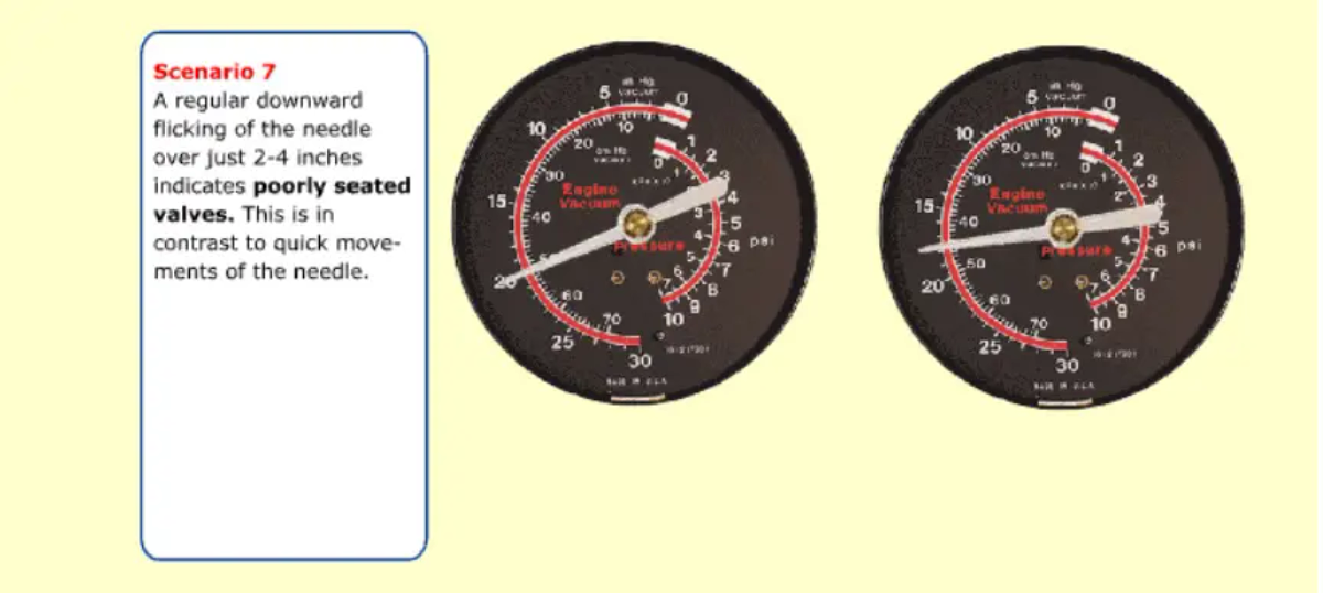

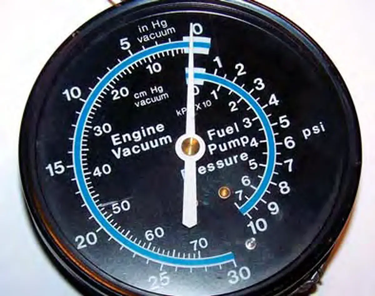

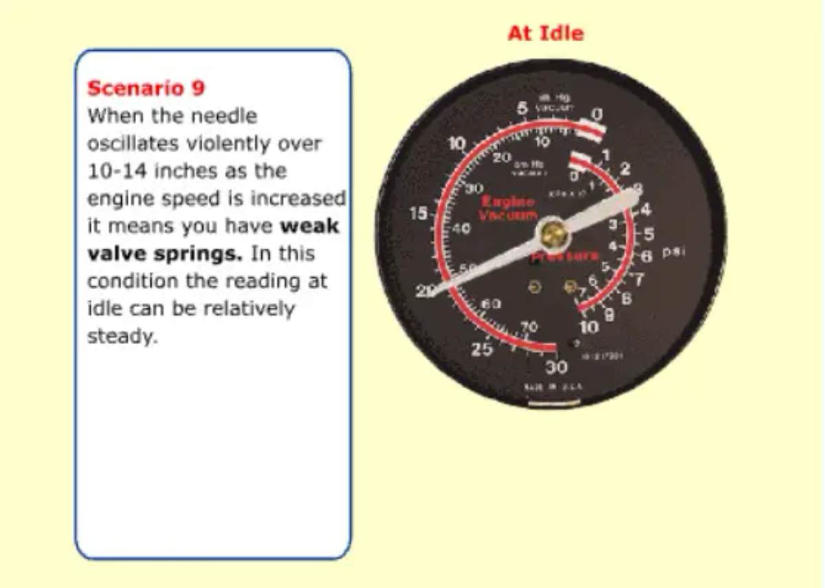

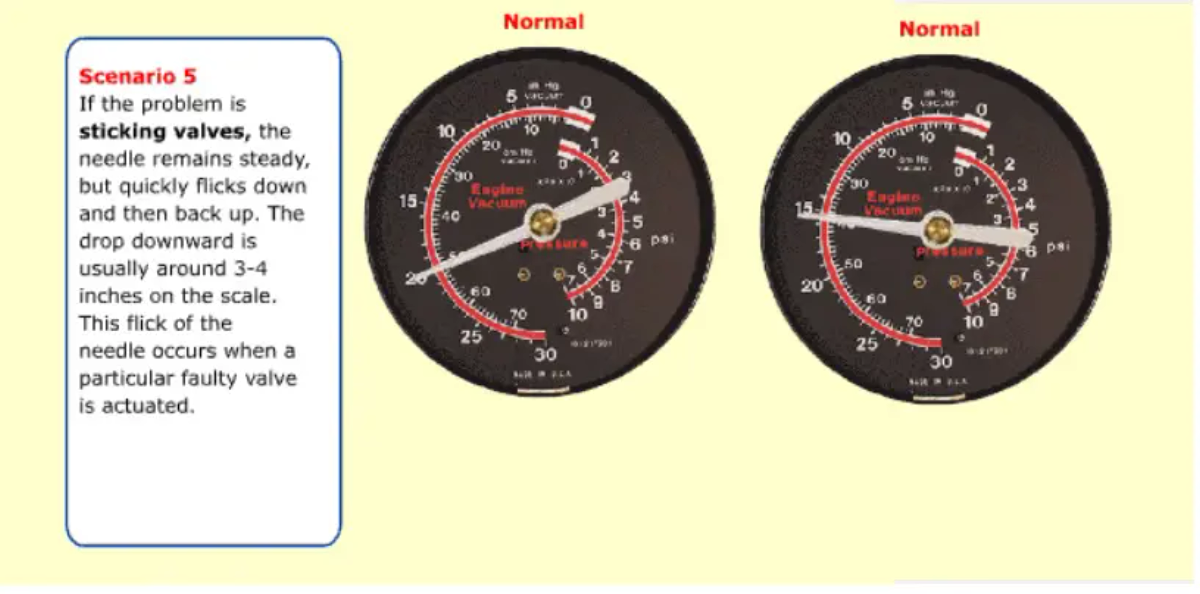

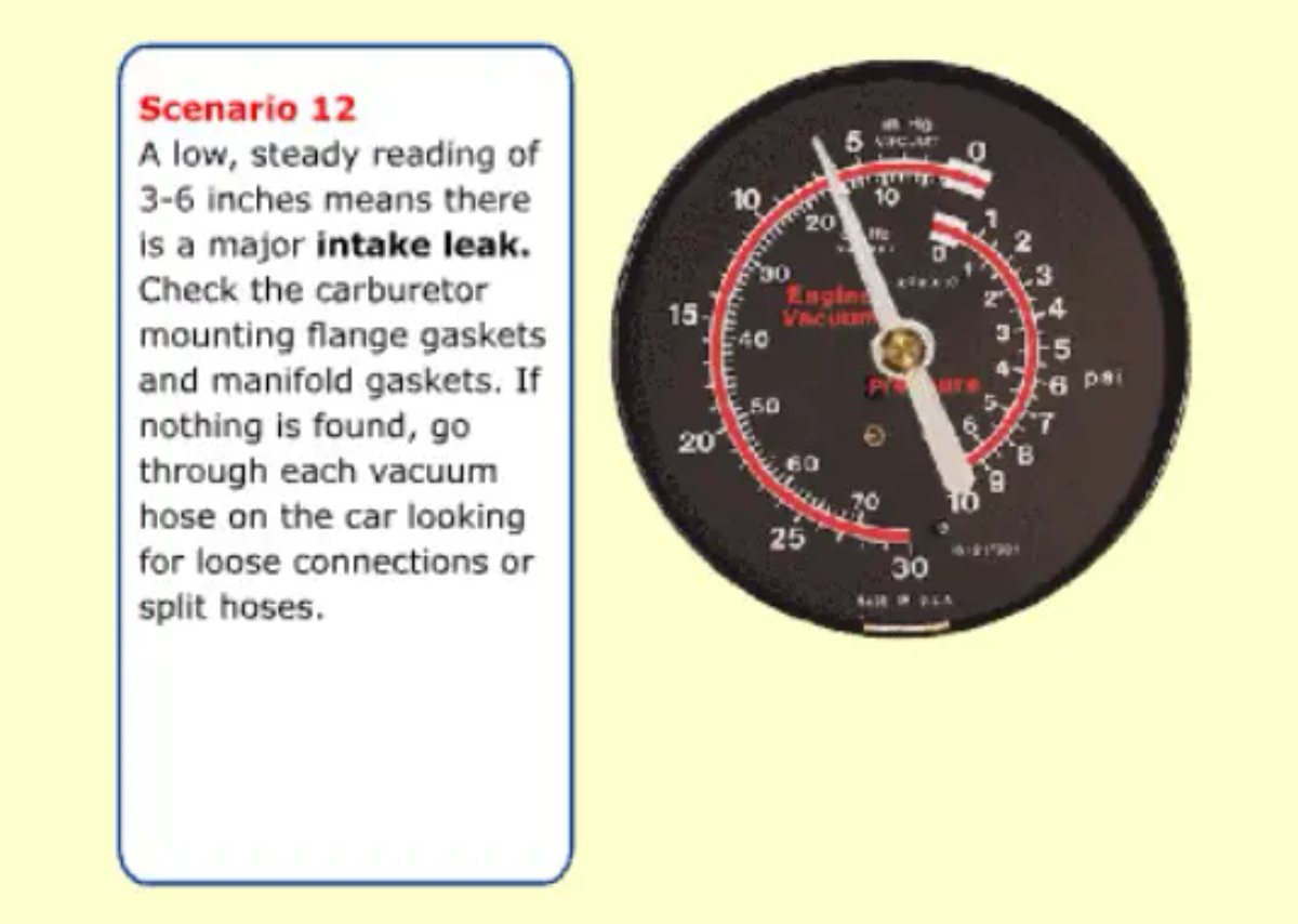

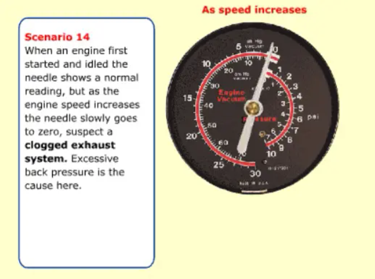

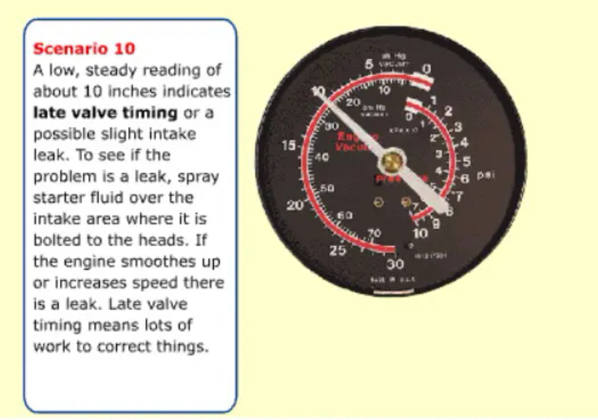

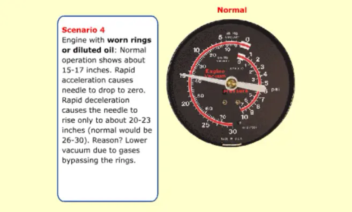

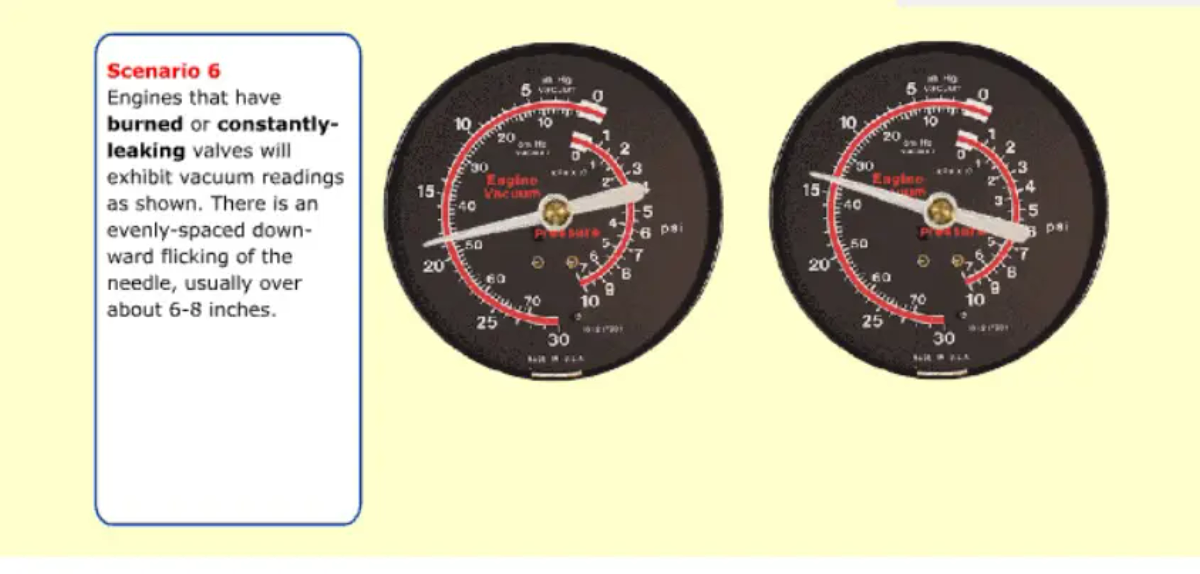

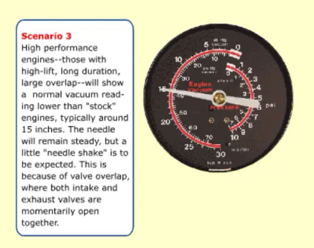

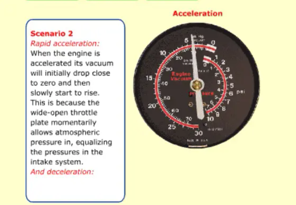

Few tools or test devices are more useful and versatile than a vacuum gauge, yet very few hobbyists own one. A vacuum gauge can tell as much about the internal and external workings of an engine as the combination of a voltmeter, compression gauge, stethoscope and timing light. Really!
An engine's vacuum readings can tell an awful lot about its running parameters, provided you know how to read the gauge in the first place. Unfortunately, most vacuum gauge manufacturers don't provide easy-to-follow instructions and diagrams to help users interpret gauge readings, rendering the gauges themselves virtually useless.
We're here to change all that, so follow along with us on a tour of vacuum gauge readings and we'll show you all the neat things you can do with one.
